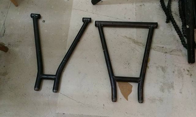

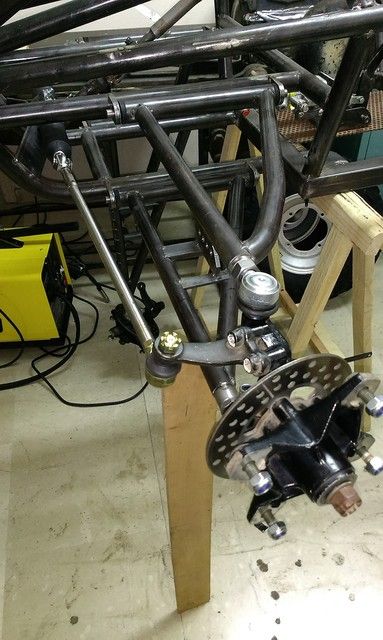

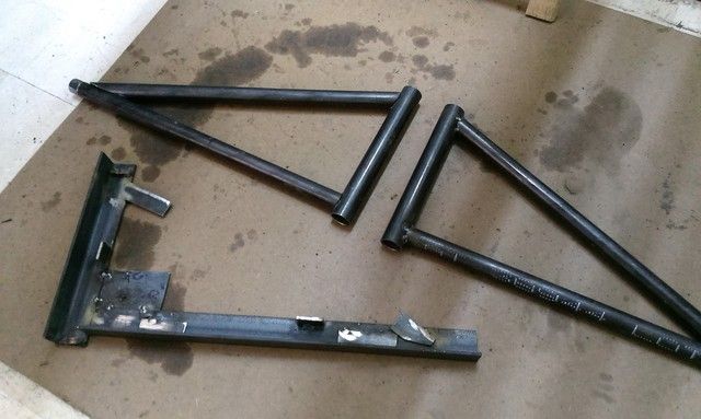

    rear arms
    front
    Re: Jig
    Very nice
    Thanks everyone for the help. Im sure I will have more questions as I get deeper into this.
