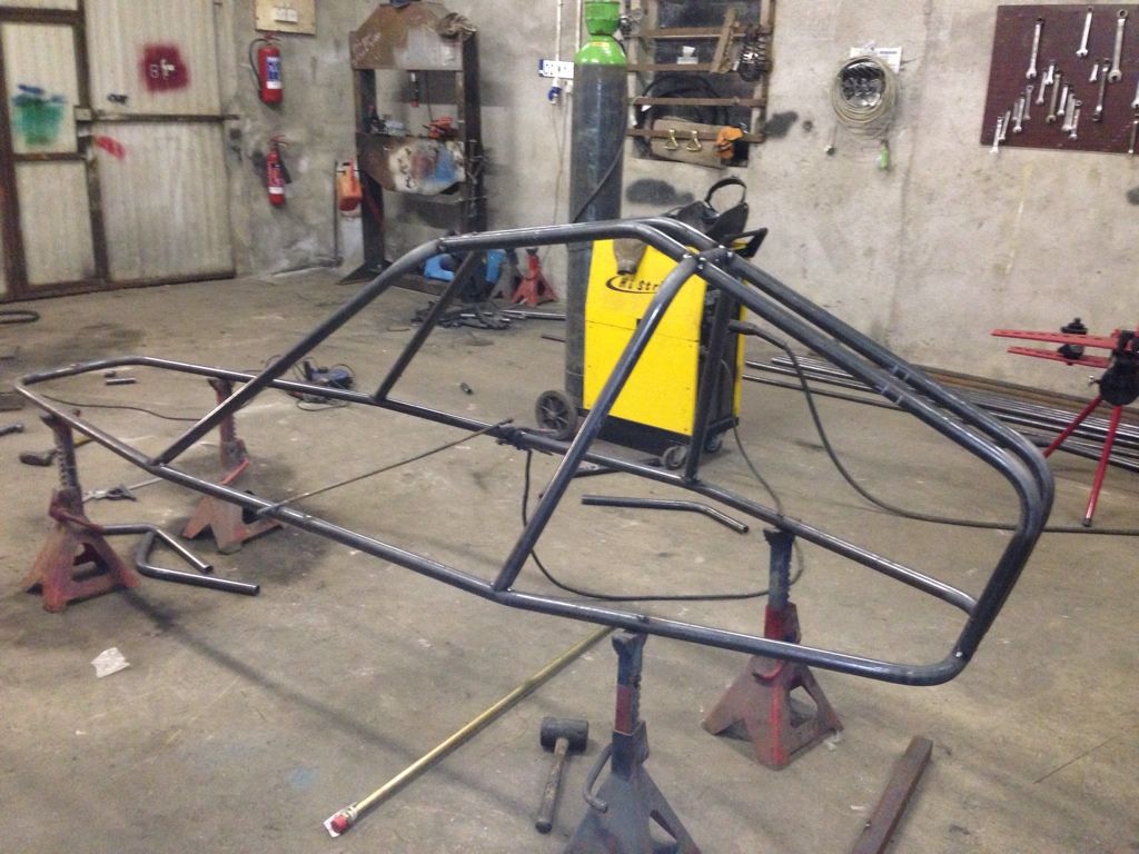

    Just started really have top section according to the plan in the pic but have decided to stray away from the plan and build the full frame in round tubing
    Also have added a rear LSD which I have completed with inboard disc brakes
    Have wheels and tyres 26 x 10 x12 rears ans similar 8" fronts
    Mini rail quick rack arrived from sand parts last week
    Gsxr 750 k5 has been mine for a long time in waiting for this build
    Have rear gaz coilovers 12" stroke but no decent fronts as yet

    looks really good! starting the drive train sooner than later has always seemed easier to me. good luck
    keep the wheels underneath you. it wont hurt so much when you come down...

    Base of frame made today in tubing as I had planned instead of box section also sat in the engine and seat to see how things line up
    Gonna have to run with my engine off centre in the frame as my diff section is soo narrow 150mm 6" between the plates
    Great for suspension travel bad for balance will use battery and accessories to counter the offset engine weight
