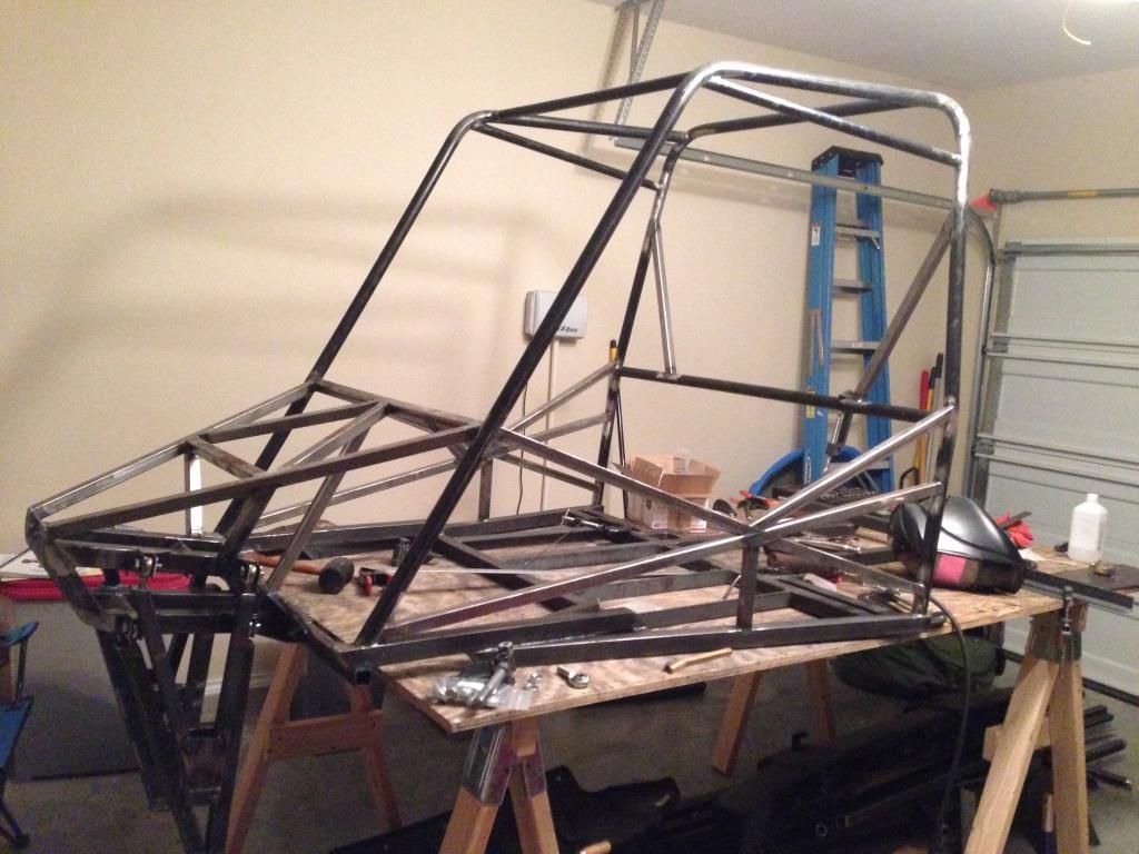

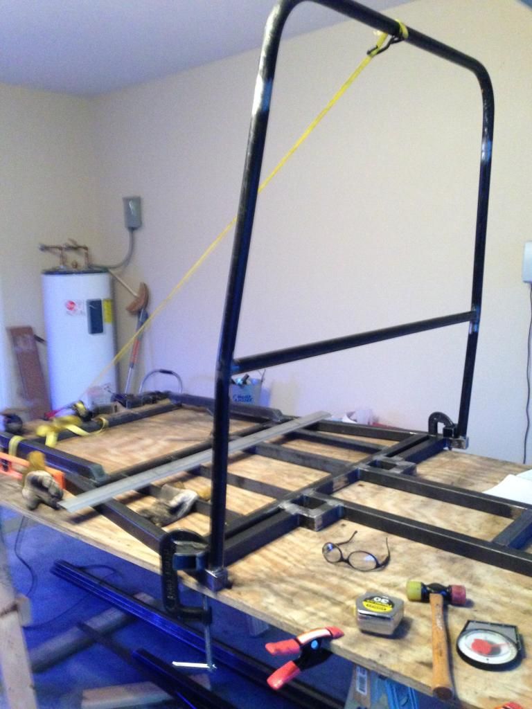

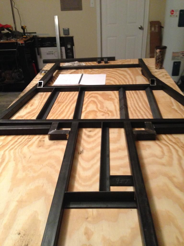

    Figured I would just start a build thread.

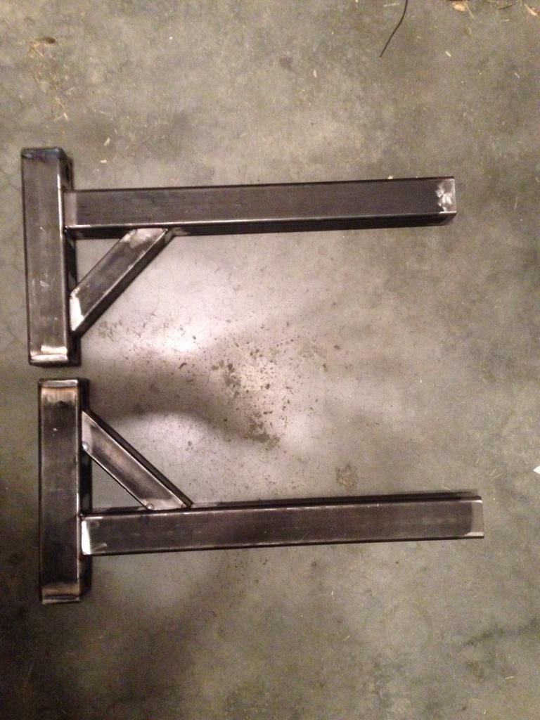

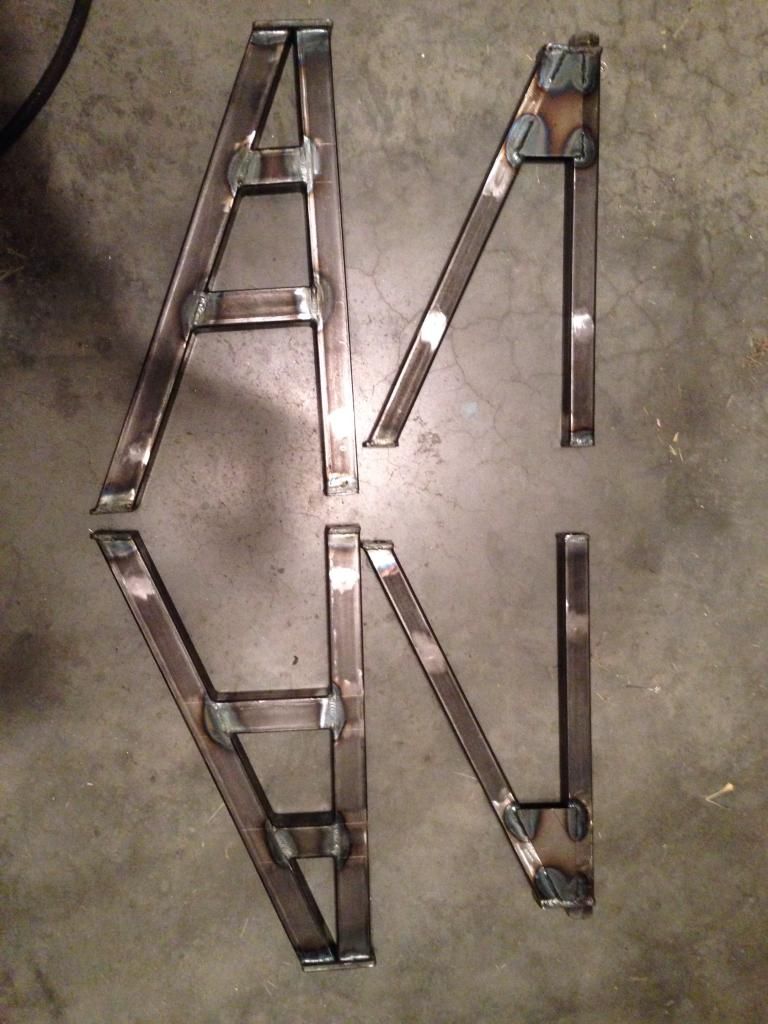

    Haven't finished the trailing arms because I think I'm going to use cv axles and I'm not quite sure how they will fit up.

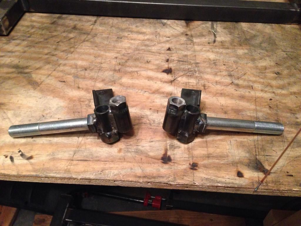

    Went with the spindles in the drawings. We will see how they work.

    Front spindles look good. I ended up using Yamaha YFZ450 (banshee style) spindles, they have brakes and all, easier than fabricating spindles and having to figure out custom front brakes.

    Im using the spindles from the drawing and they work great. My suggestion is after you get it all put together silicone the open ends of them closed so they dont get filled up with dirt and water. I found that out already.
