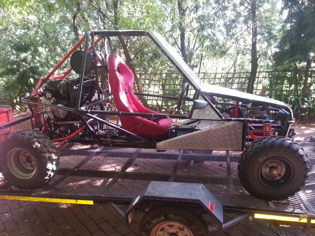

    Buggy with the fj1200 engine
    Unfortunately I didnt take pics during the process, all that still needs to be done is the axles, exhaust, wiring, radiator mounts and some other small things. Hopefully it will be fully running by next weekend, I will upload some more photos later.
    It doesn't have reverse yet but later on I will use a starter for reverse.

    Tuesday when I went to get quotes for the exhaust manifold I loosened the ropes at the first place and forgot to fasten them after deciding on another place,I went around the first corner and......[smilie=tr_oops.gif] luckily some bystanders helped me to get it back on the trailer.I received it today and fired up the engine, I will post a video shortly [smilie=ecstatic.gif}

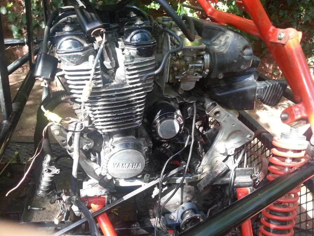

    FJ1200 buggy first (actually second) start. - YouTube
    Now it just needs a good service and cleaning, does anyone know why that cloud of black smoke appeared?
