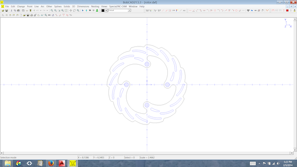

    Brakes:
    I picked up a set of XP front calipers and a set of 270mm oversized rotors for the front stoppers on Flea-Bay. Not sure if I'll do the oversized or regular sized rotors on the rears. I'm sticking with the front XP calipers on all four corners, as they work well, they're easy to get and pads are plentiful. Being able to use off the shelf parts for as many things as I can makes the world easier.

    And the designing begins.
    To do a car correctly, we have to start at the wheels and work in. Front suspension is first.
    To figure everything out, I have to design the hubs first, then put spindles in place and work in. To design the hubs, I needed to have my wheel specs and my brake specs, hence getting the calipers and rotors. I want the calipers to be as close as possible to the back of the hub, but not have an issue with things hitting if anything flexes. From there I can design the spindles knowing the tire size, the back spacing of the rims and such.
    The CAD sessions start. I'll post up as I get stuff done.
