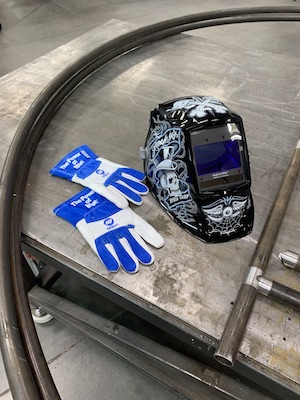

    I've had a couple of sticks of 1.25x.065 chromoly tubing floating around in my possession for over 10 years. Guess it's time to use them.
    525 Industries tooooobing prep tool, Miller gloves and a brand new bad ass welding helmet with a well set up TIG welder were used.(Thank you Kustomfab!!!) It's full race spec Nuptial Ring.

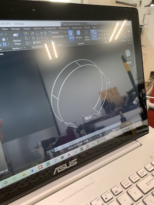

    This was the plan:
    Rolling a flat ring is a bitch - especially with a manually run Harbor Freight roller.
    Keeping this thing aligned whilst turning the steering wheel on the table turned out to be tricky. Had to hold onto the toooobing with a pipe wrench and try to keep it spewing outta the roller as straightly as possible.
    It took me a few passes to realize that it was a lot easier to roll and control when I only added one turn of bend instead of the two turns I started out with.
    Didn't come out too badly. I tucked the ends of it up under the build table and bent it flat.

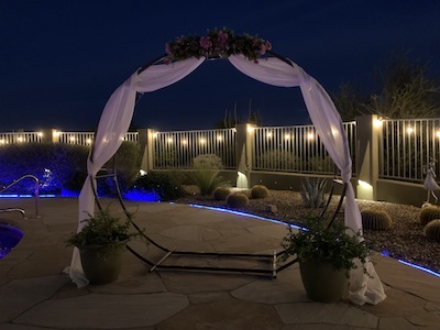

    Finished product:
    Here's Robyn test locating on the back patio (where the ceremony happens):
    So the photographer keeps talking about sunlight and direction and such - check this out, we'll have the perfect Saguaro shadow during the ceremony.
    And here it is going thru it's dress rehearsal. It'll go back up in a couple weeks.

    Good Kfab. Keep the Mrs happy.
    It's one hell of a back drop you got there. Rather jealous.
    All dressed up and waiting for the beer to arrive.
