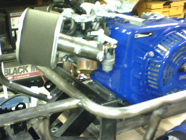

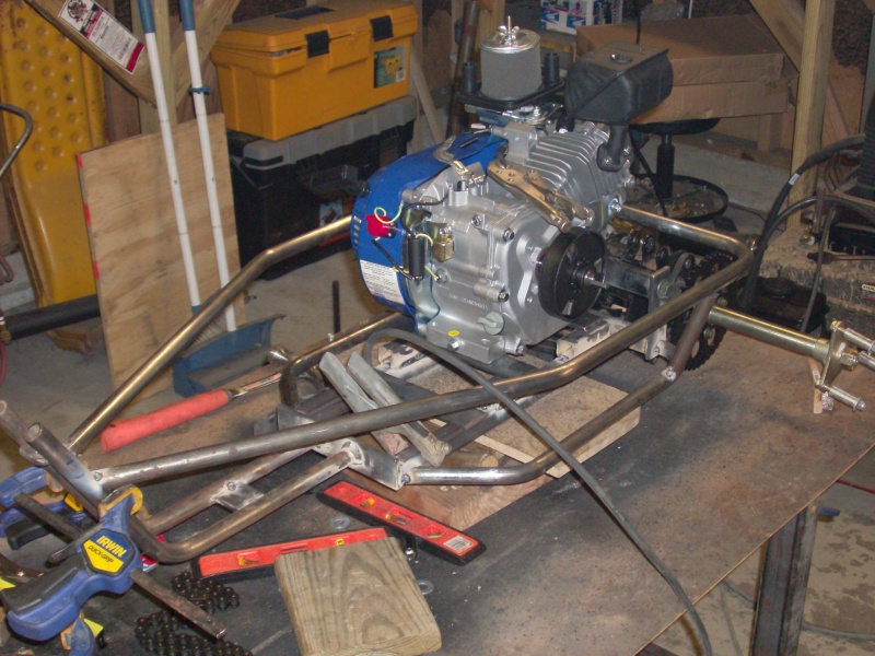

    small update... had a couple of issues with where the b pillar was going to go(air filter was in the way) and the height of the roof(too high making it look un-proportional)... so...

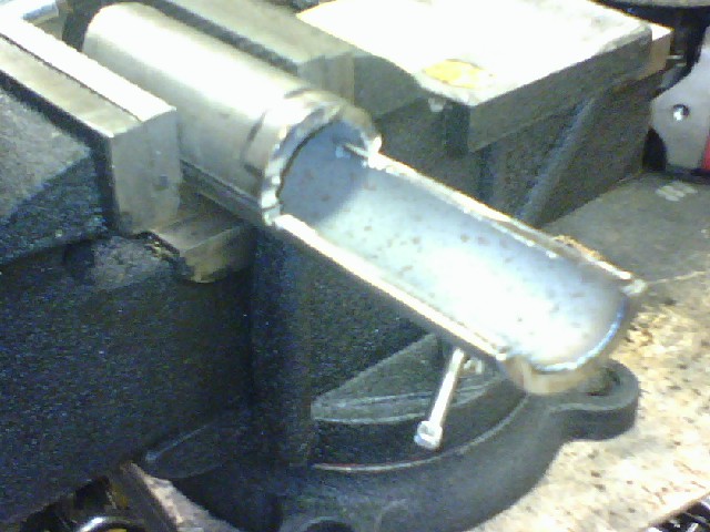

    i took some 1.25 tubing and started cutting it...

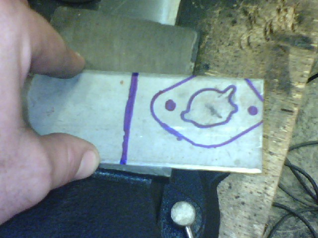

    then, took some flat bar and traced the gasket and started cutting to fit the 1.25 tubing...
    after welding and some grinding:
    so, the air filter went from this:
    to this:
    and of course, this made me realize i could go lower with my exhaust than i already have... so, i started chopping it up again too... and ended up with both a lot lower:

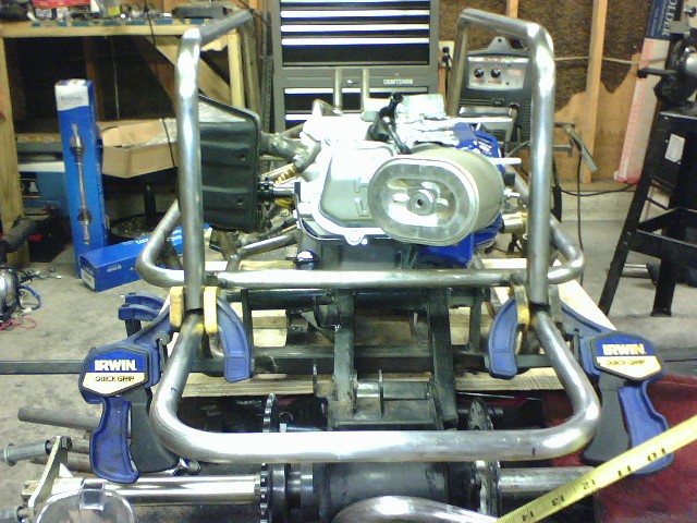

    once that was finished, i started on the upper half tubing(pictured in above pic)... still need to notch the back pieces so it will sit lower and the angles will look right on the front and rear pillars.
    view from front:
    that's it for now..
