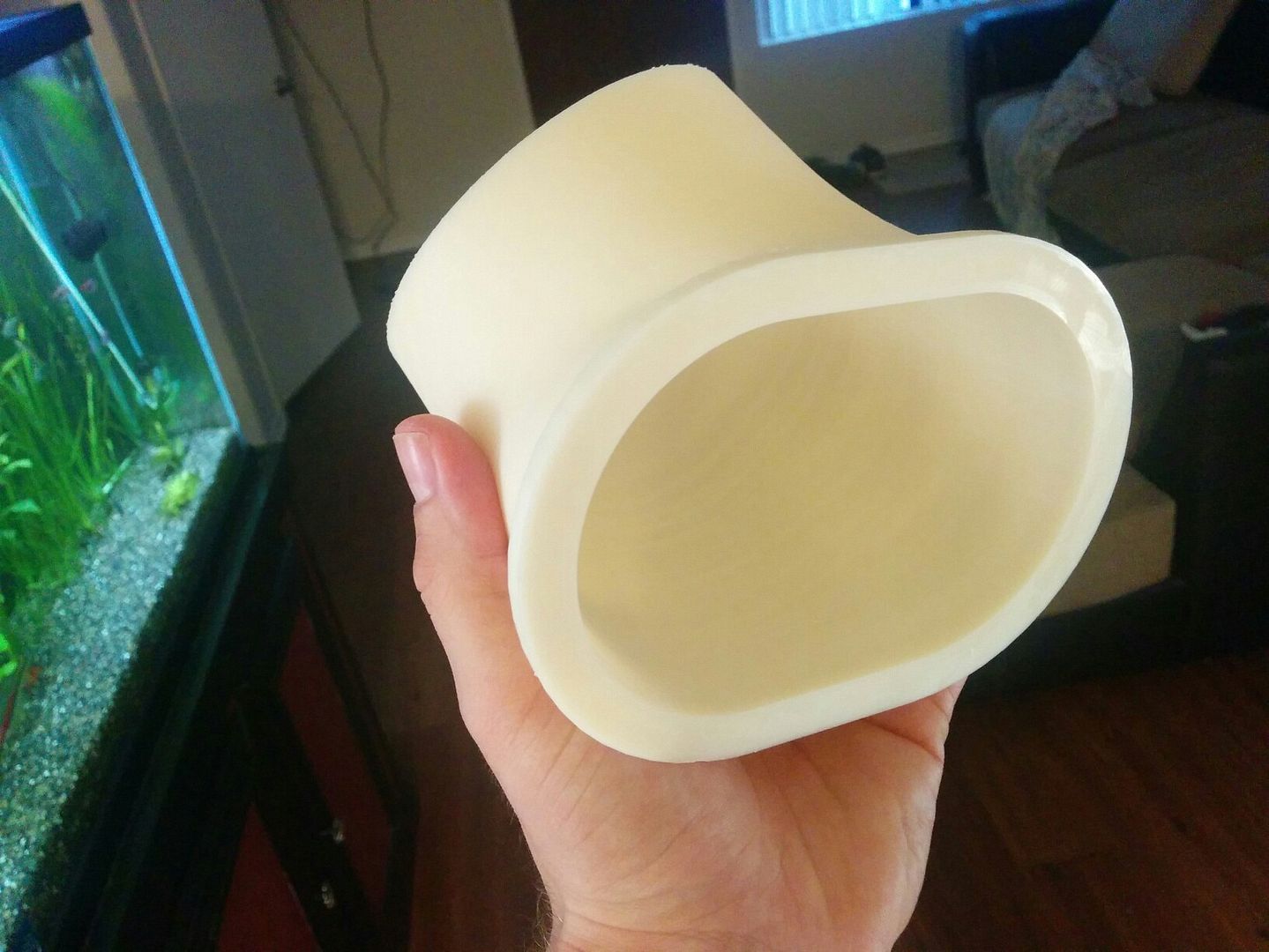

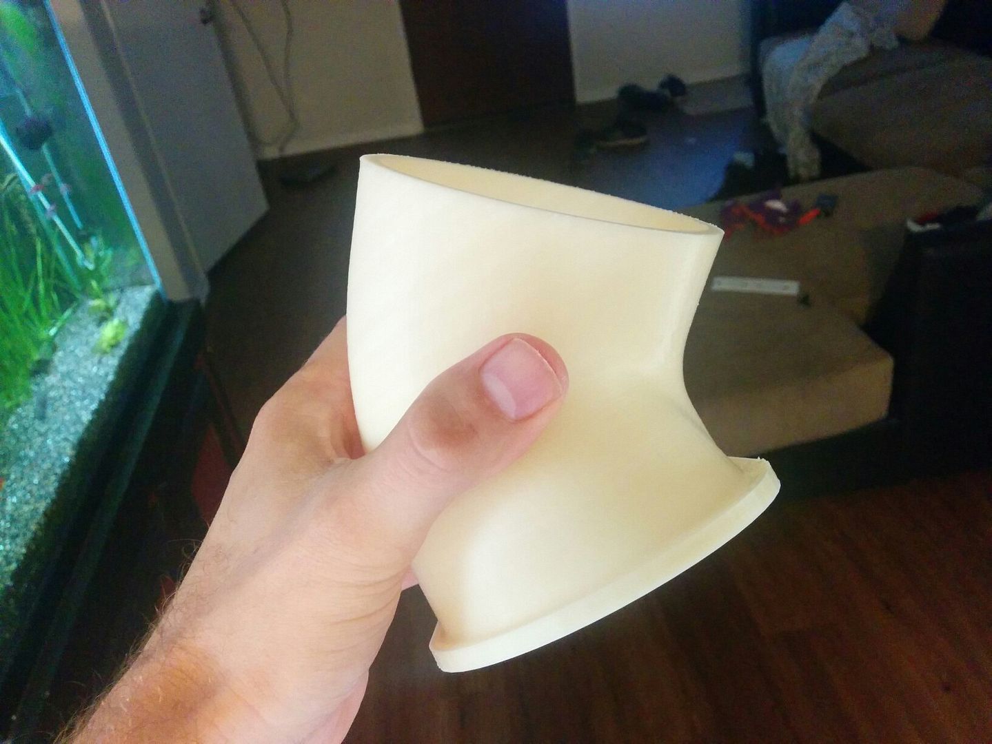

    I added 2 TRX250R UNI filters to the inlets of the airbox, used some ABS 45 degree pipe fittings, formed them using boiling water, made some flanges, some screws, ABS cement and done. I also have some of those adaptors being made using a 3D printer.
    I'll post some photos later, if interest I'll see how much the guy wants to make more.
