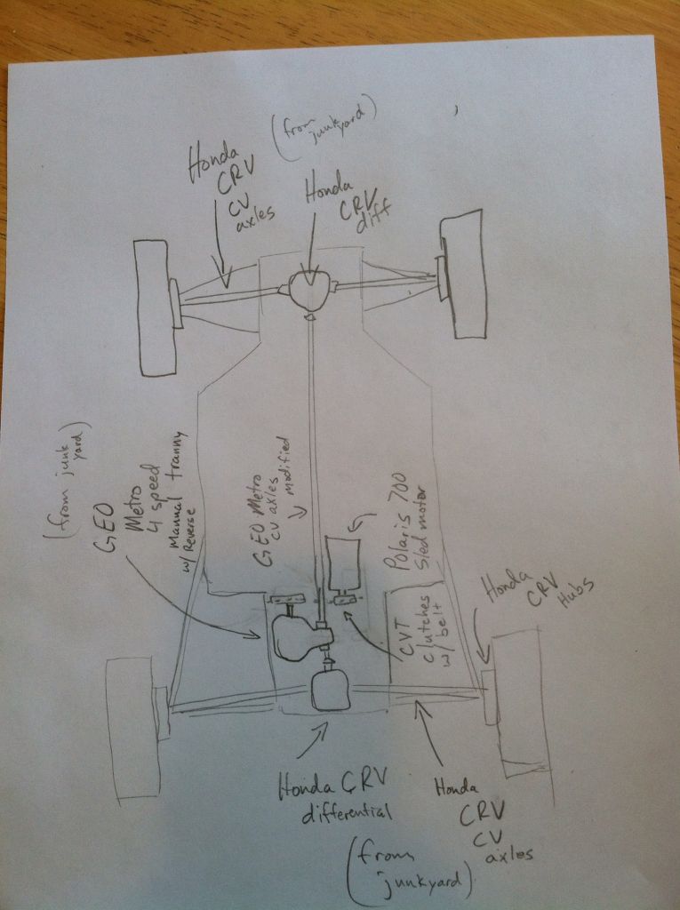

    Re: built in reverse engines
    Here's an idea.
    Minimal custom fabbed / machined components. Lower cost (junk yard sourcing). Reverse. Huge gear ratio range between the CVT clutch and Geo Metro tranny (crawl through the woods and over rocks or haul butt through the desert). Minimal shock loading components because of the CVT clutches from the snowmobile. No shifting and no clutching necessary - the CVT would work kind of like a slipper clutch - but you could still use all 4 gears in the Metro tranny when you want to.
    The Honda CRV CV axles are long and with the flex capability of the joints, they should give you the travel you're looking for.
    If I was building a mini "King of the Hammers" buggy (which sounds kind of like what you're going for), this is what I would do.
