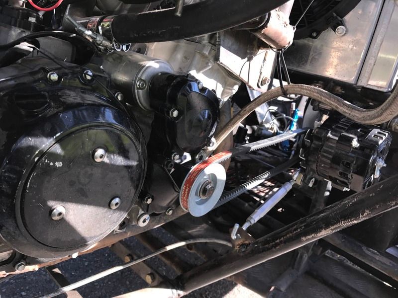

    Re: Electrical loads and consumption for busa buggy
    PLKRacer, do you have apicture of the alternator / RPM setup? I am curious.
    Nice setup studio,
    i will go to this route if you provide me the way how to do this setup, it shown that you attach the pylley to starter clutch output shaft, studio can you provide me what parts and hardware required for this setup? Such as adaptor, bolt length and pulley size with the ratio to alternator, thanks in advance
    midgettII_busa.......I purchased the motor and alternator setup already installed by jd66 .....i dont have the info on the parts but this link is where he starts the alternator process
    https://www.minibuggy.net/forum/proje...-buggy-39.html
    Quote Originally Posted by studio5o View Post
    thanks dear, i will have a look on the link
