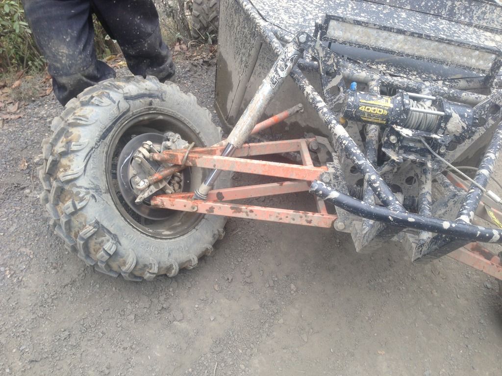

    Time to redesign the front end soon it won't be an st4
    Oops
    Re: Time to redesign the front end soon it won't be an st4
    looks like your heims are what failed
    Looking at the failure - the body of the heim being pushed back - I have to ask, did you hit something?
    Catch a stump or rock while turning?
    Sorry haven't been on actually the steering arm lock nut on the outer heim got loose and allowed the arm to rotate so that the small heim on the end of the rack was sideways and as soon as I started up the next hill the compressing of the front snapped it and I was going pretty fast so with the steering not hooked up the wheel just opened up as you can see
