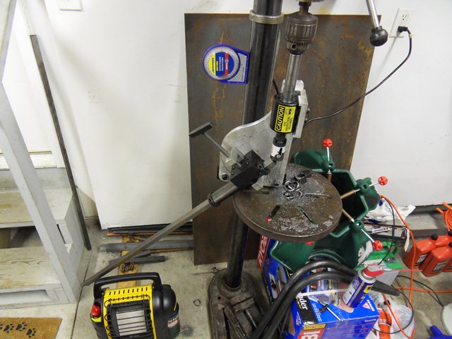

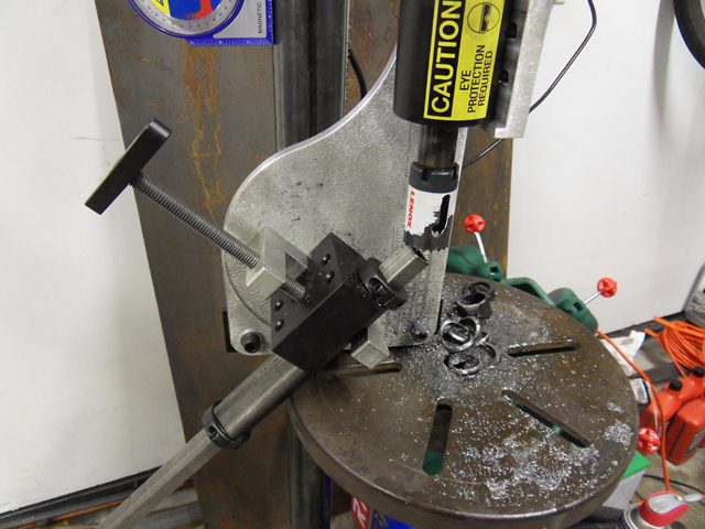

    I used a tube notcher. Harbor freight sells one, but I opted for a pro-tools unit. I even made a compound angle attachement so I could rotate small square tube too.

    thanks wj, i assumed my harbor frieght notcher was only for round tube. I will stick the square in and qive it a try. If that doesnt work, i will use the link ironknot listed and grab the cutoff wheel.
    Thx for the help
