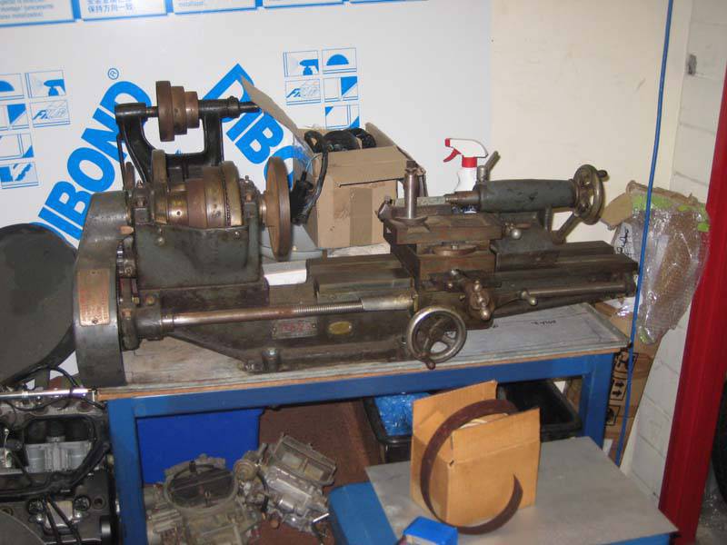

    I've had the plans for a few months, but I've had to make a table for my 1940s lathe that's getting wired up today and a new belt fitted.

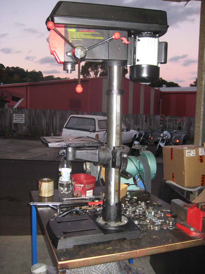

    Also bought myself a drill press

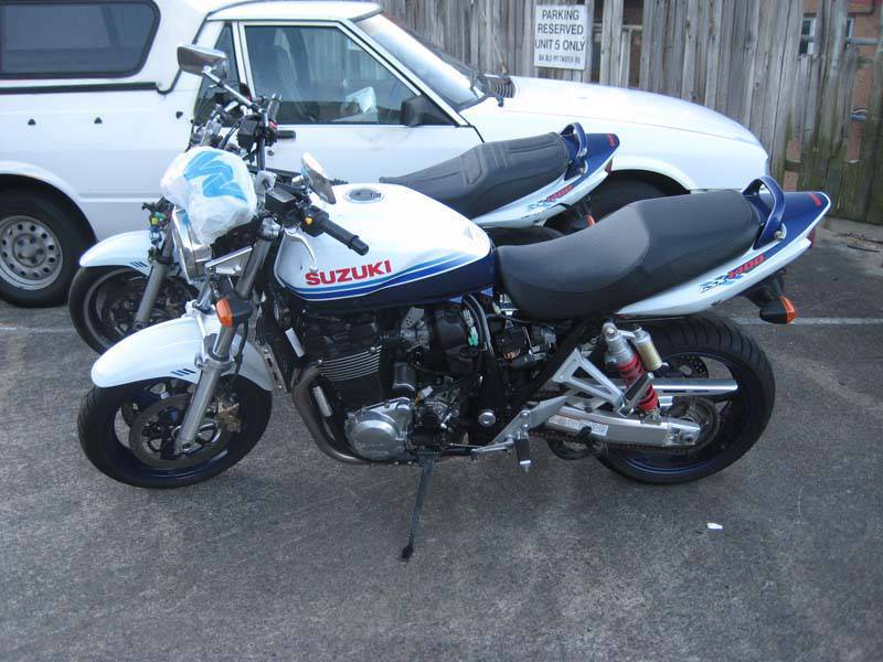

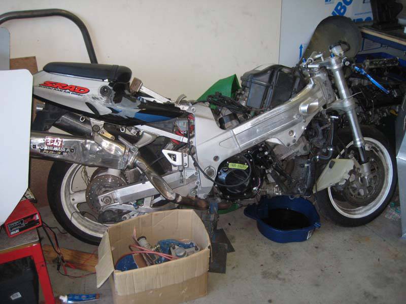

    For an engine I have a choice between a TLR1000
    Or a GSX1400
    I'm leaning towards the TLR, if only for the V twin soundtrack, but the GSX has serious torque and doesn't need to rev like a GSXR to make power.
    On the downside the GSX is air/oil cooled so getting enough air in to keep the motor cool might be a problem

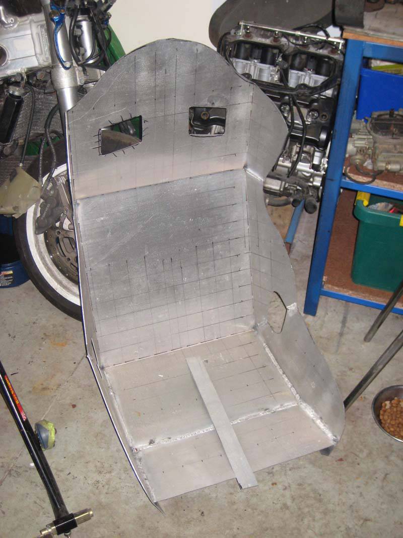

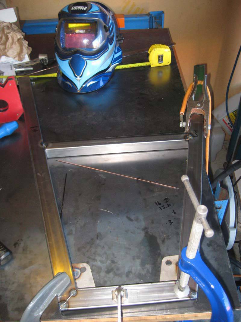

    I made a seat for the Piranha, that might go into the AR51

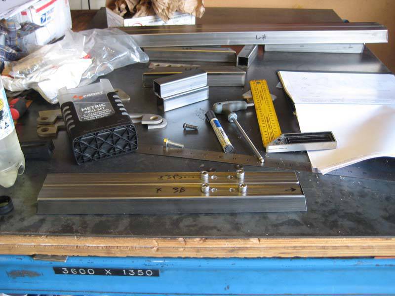

    And finally, I've made a start on cutting some tube.
    It's not a lot, but I should have all the front end tubes cut today- once I get my head around all the inches to mm conversions.
    I must say, Rick's plans really are well thought out and easy to decipher and having wjfawb0's and Sodmans threads to follow will make the build easier.

    [quote=Large;237420]For an engine I have a choice between a TLR1000
    GO WITH THE TL MATE!!!!

    Yeah my vote would be the TL as well.... My brother had one... and well awesome bike to ride... Because of the low end power. And standing behind the bike you get this pulsating in both ears and it will mess with your head, but you'll never forget that moment (Shit sounds like some thing on a Hallmark Christmas card!!)
    If you have ever been behind one you'll know what I mean. Any street bike Fan will know what I mean.

    I've got a TLR motored custom bike, so I know and love the sound, but the stump pulling torque of the GSX means I wont write it off as a choice yet.

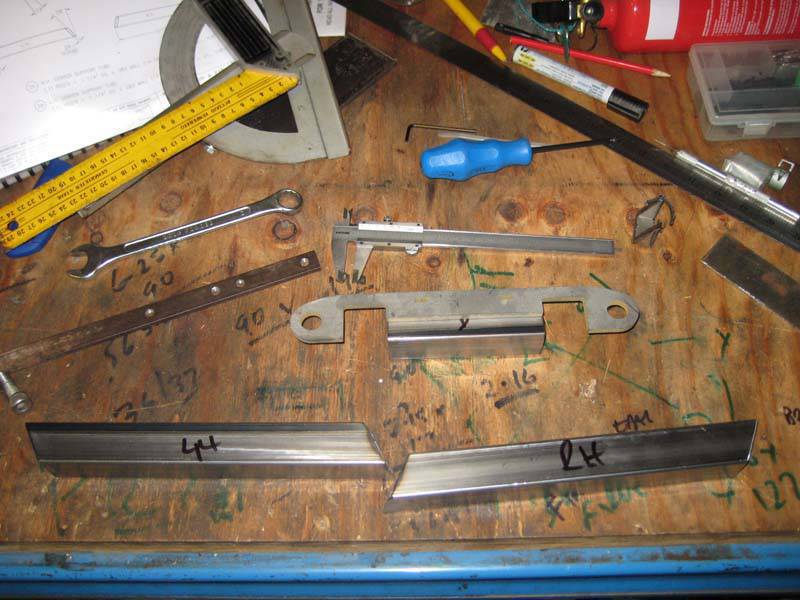

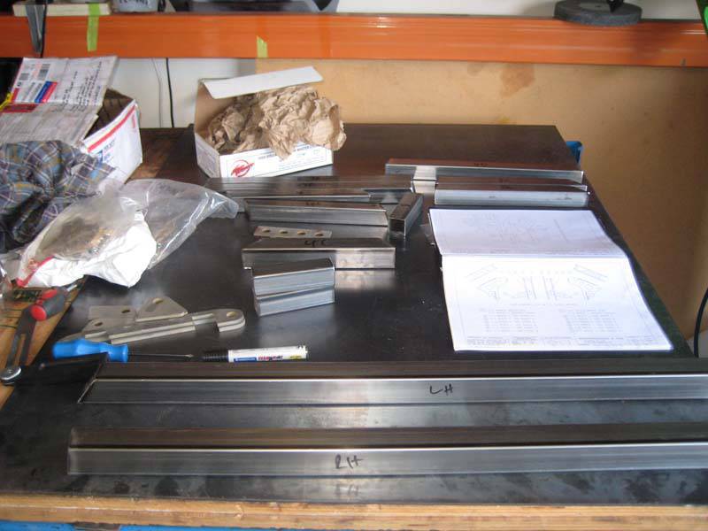

    I spent the afternoon cutting all the front end tube and sorting out the laser cut brackets, so now I've got a kit of parts.
    Going to fire up the welder tomorrow and get the sub assemblies tacked up.

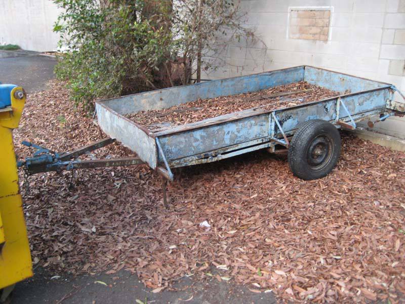

    As a bonus, it appears this trailer parked behind my place is dumped. It's got rust, but the frame is ~ 3m by 1.8 m, which is just about perfect for dragging a buggy around.

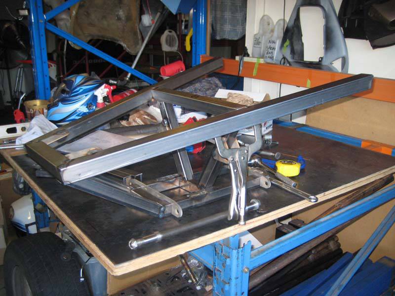

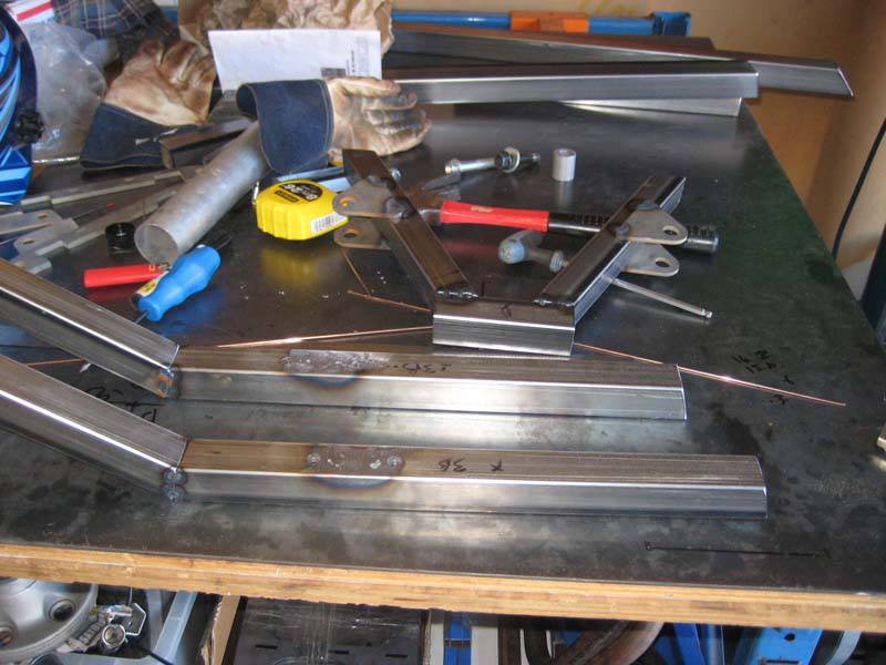

    I fired up the tig today and got most of the front tubes tacked up. A couple of times I thought I'd found a mistake in the plans...but it was just me not reading something right. I'm really enjoying this- it's like a big model kit.
    Couldn't help myself setting up the tubes to see how they lined up.
