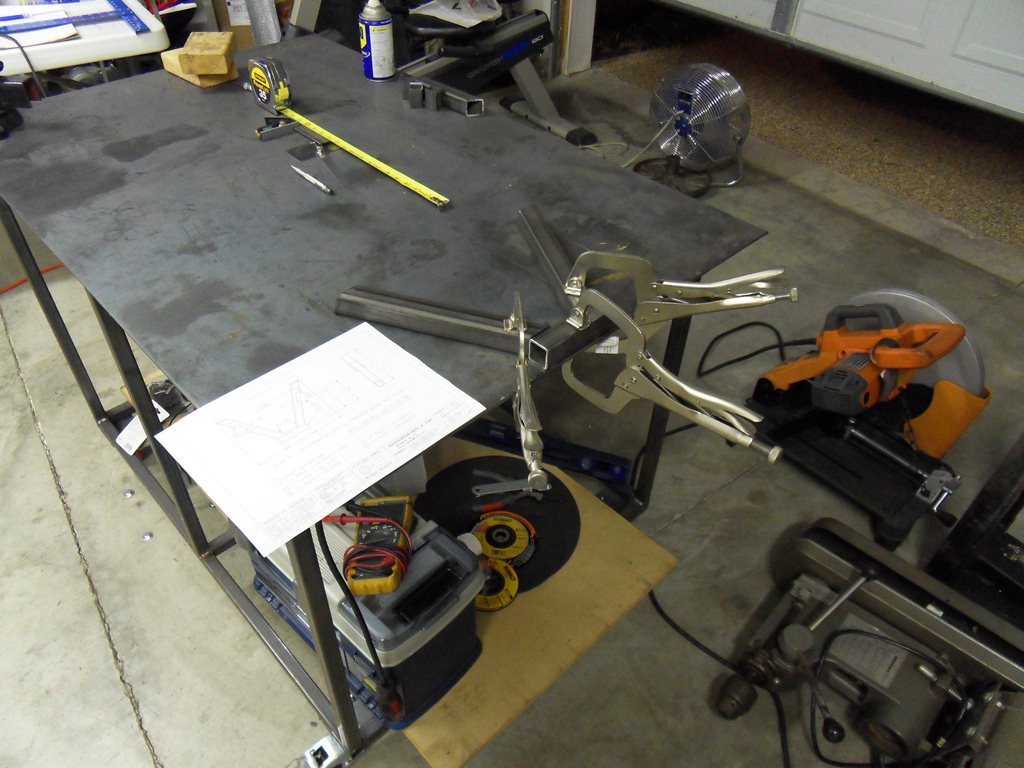

    I was converting the drill press from a bench model to a floor model so I could get full range of use out of my protools tube notcher. The table height range of the 32" 2.5" pipe stand got replaced by a 5' 2.5" pipe, and I had a friend turn a new collar so that I could move the table rack up and down the pipe for more flexibility. I bought this 82 model duracraft from a local guy off craigslist because it has a 1725 rpm 3/4 HP motor, and the lowest speed is 195 rpm.

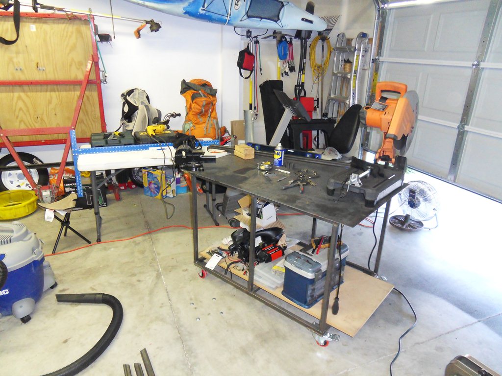

    A few more pictures. Hopefully I'll have the front end together in the next couple weeks.

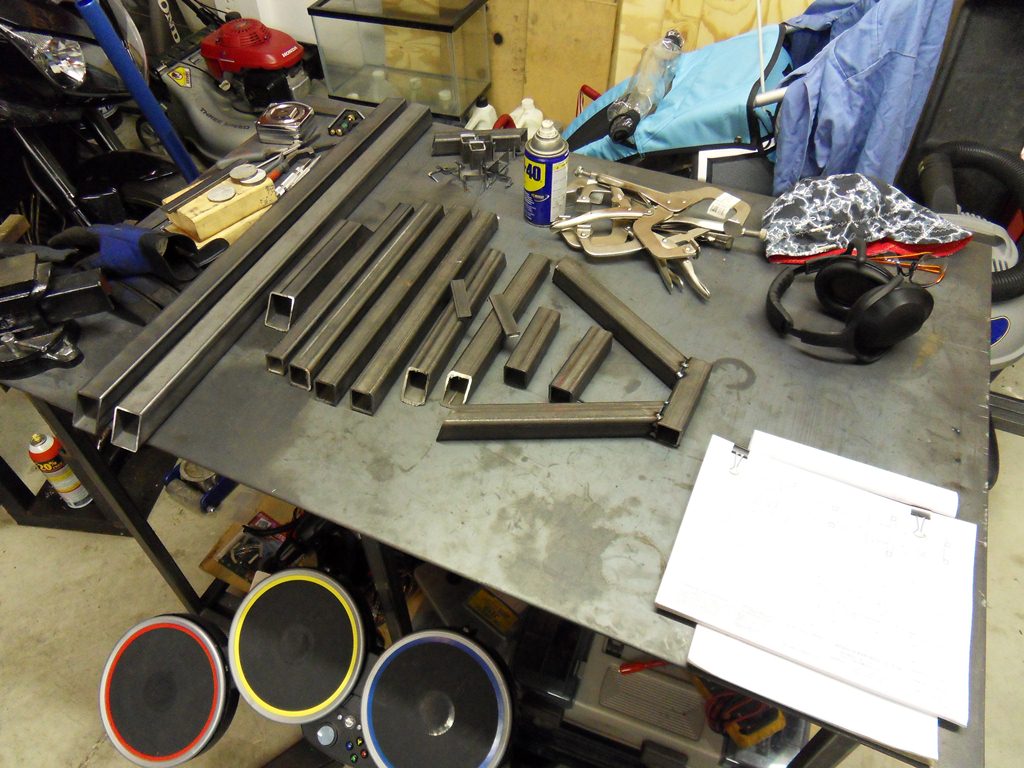

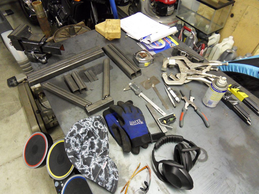

    Pile as of yesterday:

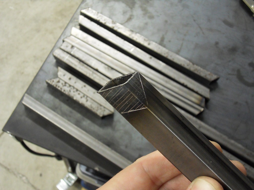

    More tubes from tonight. I'm using a chop saw for the first angle and then a cutoff wheel for the second on compound tube ends:

    Re: AR51 build in KY
    Sep 2011
    Chattanooga, TN
    390
    I move stuff around and use a big fan with the garage door partially open when I'm cutting and grinding. I usually take pictures after I clean up and make room for the wife's car again. My wife relocated a lot of things to the garage when she had one of those pyramid scheme parties (tastefully simple/candlelight/scrapbookers anonymous/etc.).

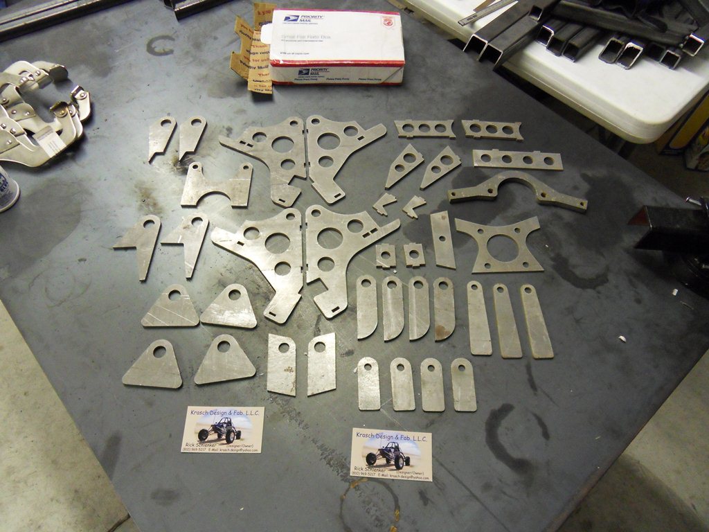

    Got my first package from RickS. Somehow he got all those parts into that small flat rate box:

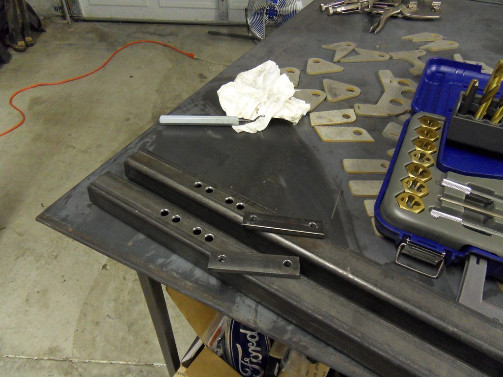

    I started putting some holes in tubes and bar for the steering rack mount:
