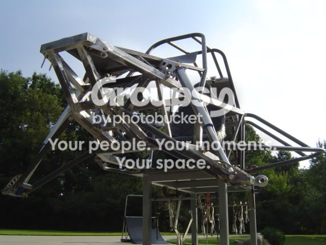

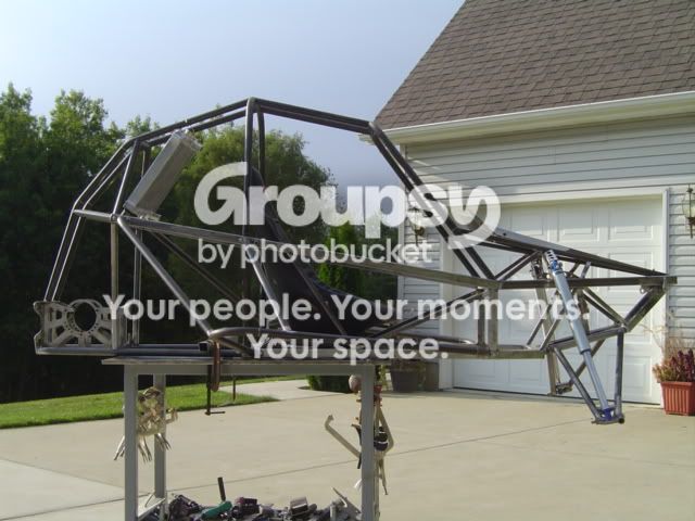

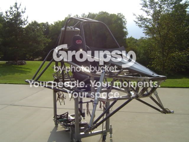

More progress on my frame this week.
Nerf bars, radiator and seat mounts are done.
I'll be doing the dash and steering column brackets next. Then full weld what I've done so far.

Not much more to show right now. Ran out of 75/25 this afternoon, so it will be Monday before I can finish welding. I'm also making a new longer set of lower a arms for the rear. These, plus custom boot flanges, should allow me to push the type 4 cvs to 28 degrees. This is my goal anyway. Hopefully I'll have a roller by next weekend.
